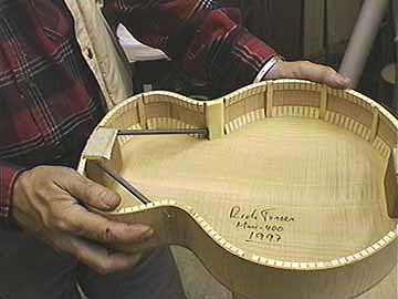

And a pic from the archive of one of Rick Turner's:
I put a couple of these braces into an eBay 'project' guitar recently- they sure lock that neck block in place..thanks to Rick, Howard, and the other folks I got this idea from!

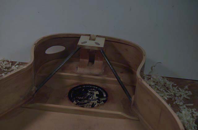

Bruce,
What Rick said. I use 2 per side as well on the basis that the those at the top are in compression and those at the bottom in tension:

I started doing these in around 1990 using wood flying buttresses.   I rebuilt half a dozen flattops into baritone guitars for various customers, and as long as I was re-topping them, I figured I'd might as well stiffen up the whole box. It worked like gangbusters.
The little archtop mando-guitar in the picture was from '97, and on that I used two CF rods. Now I use four, all in compression to the top of the neck block and splayed to get some triangulation, and I also top the center seam reinforcement with CF to get the tension strength to the bottom of the neck block.   The CF on the back strip also adds incredible strength and stiffness to the back.

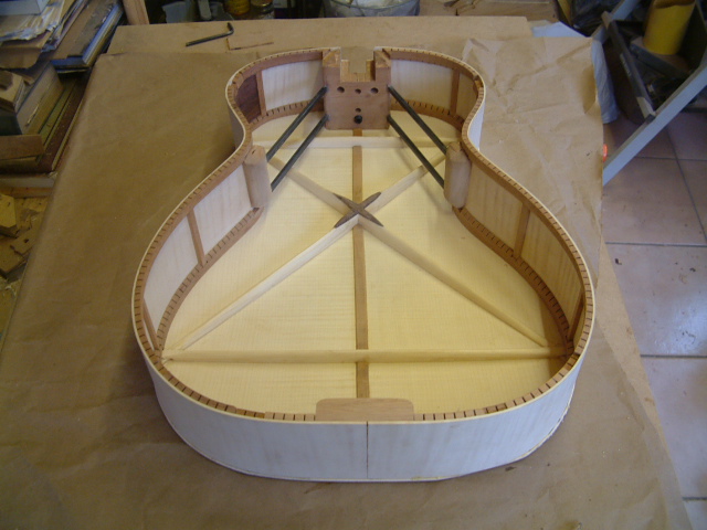

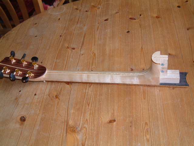

I'll give you my reasoning. The neck under string pressure pushes in on the top of the neck block and pulls on the bottom of the neck block - potentially over time the lengthwise back arch can be pulled straighter, with the neck block and neck angle changing. The top pair of rods under compression resist the push in of the top of the neck block and take the string load into the sides. My little brain says "fine, but the bottom of the neck block could still move out over time due to the pull and flattening of the back arch". So I use a bottom pair as well that are under tension. It may not be such a big risk but it is pretty easy to put in another pair as insurance.
If you look at the gap in the neckblock in my picture, this is where my flaoting neck extension goes. Rick uses dadoed cf rods under the fingerboard which is way cool but I just have the neck extending under the fingerboard like this:
People like Rick, Mike Doolin and Howard Klepper have been inspirations in developing my instruments this way
